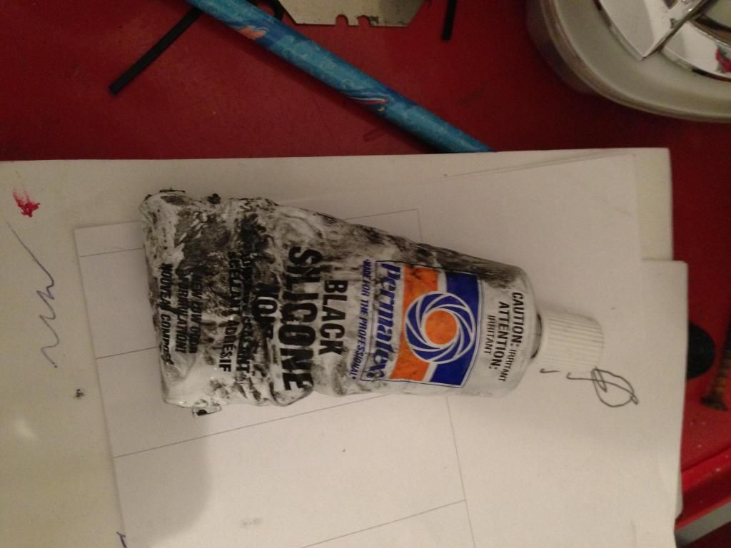

6. Then seal the seam of the lens/housing with a small bead of sealant. You do not need a big glob of sealant but just a small bead into the seam. (Thanks to RaulGCustom for the info of what to do and the recommended product.) Run your finger over the bead of sealant to squeeze it into the seam. Saliva on your finger works better for spreading the silicone than water.
Here is a pic of the tube of Permatex Black Silicone I used:
7. Let the sealant dry before placing the headlight back into the car. (Also do not over tighten the headlights as it is very easy to crack the tabs the bolt goes threw.
8. If you still have condensation right after this procedure do not panic. This will most likely be due to left over moisture in the headlight which will eventually evaporate threw the breather. I had this happen on the passenger side headlight and within the first month the condensation dried up.
